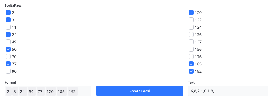

soweit - so gut. Beim Versuch die SceltaPaesi auszulesen, bekomme ich ganz eigenartige Adressen (rechts unten im Bild mit Feld Text ist das Ergebnis - links unten ist die Darstellung der SceltaPaesi in eine Formel).

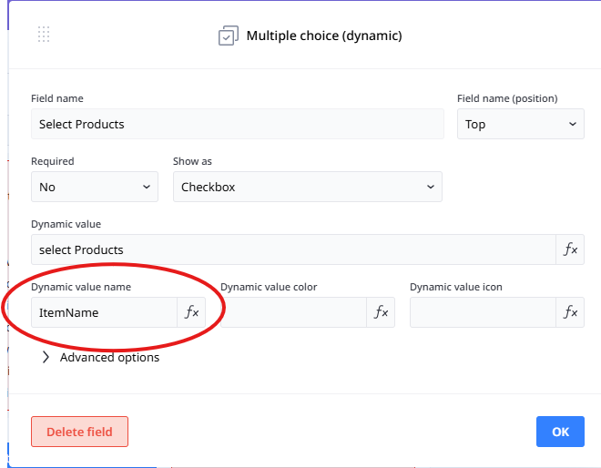

    When you create a dynamic choice field from a table, Ninox is creating an array of record IDs. When you create your dynamic field you have the option to select the data you want to show in the field. The Dynamic value name is where you set it.
    In my example I select all records from the Products table and show the data from the ItemName field.

    One way is to use the numbers() command. The Show Numbers field shows you what you get when you use the command. Ninox returns an array of numbers (6, 15, and 17), which correspond to the record ids of the products selected.
    Another way is to use the text() command. The Show Text field displays a string of the data that is used to display your choices.
    The most important one is the record() command. Since you have the record id of the selected choices you can use the record command to retrieve the exact record you selected and then get any data that is available.

    You can change the Dynamic value name of the field to show the country names.
    You can change the formula for the Text field to:
    for i in numbers(SceltaPaesi) do
        record(Imprese,i).Nazione
    You see now you have an array of country names.
    • Seba.1
    Great! Thanks a lot for the hint: The only thing I had to do is to change SceltaPaesi in numbers(SceltaPaesi). SOLVED!!!
