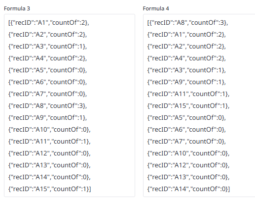

    You can use JSON to create a new "table" that has the count in it then you can sort by the new "count" field.
    Here is an example:
    You can take this code:
    Formula 3
    (select Table1).{
        recID: Id,
        countOf: count(TableA)
    then you can add the order by
    Formula 4
    (select Table1).{
        recID: Id,
    } order by -number(countOf)
    You can see that Formula 4 adds the order by command. As JSON data is typed as any, we have to use the number() command to convert the data in 'countOf' into a number. Then we use the simple '-' in front of number to tell Ninox to do descending.
    • Fred
    • vor 10 Monaten
    I think this will work with your code:
