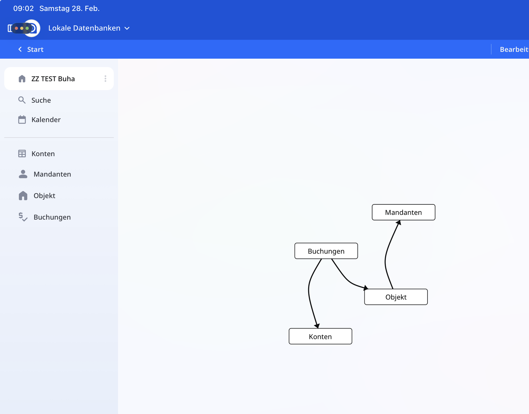

      Thanks  for the quick reply. The booking is connected to Accounts. However Objects are not connected to Accounts. That might be the problem. See picture.

       Objekt and Konten are related through Buchungen. So if you are in Objekt then the following code will get you Konten:
      Buchungen.Konten
