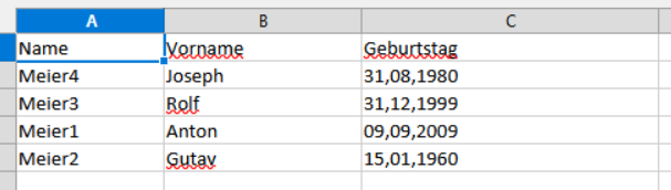

    In your row section remove the this. It is not necessary. In addition, you will need to add the format() command around your date field or Ninox will output milliseconds.
    let rows := (select Tabelle1).{
            Vorname: Vorname,
            Geburtstag: format(Geburtstag, "DD,MM,YYYY")
    Here is the output after the changes.
    I've also attached it.
